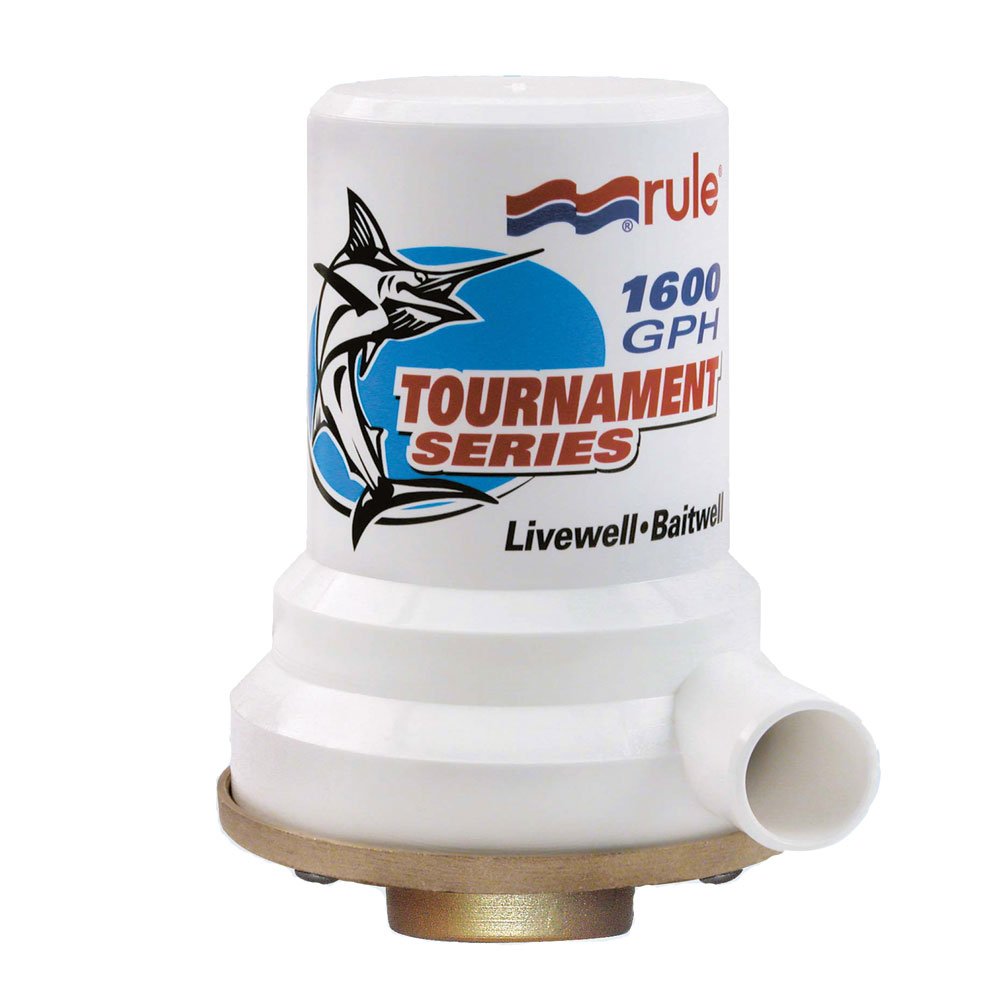

Over the years, I've found less priming issues with the Rule 1100's. Also, the body with the outlet port can be turned independent of the inlet port, so installation is a bit easier because you can tighten the pump to the inlet as tight as you need to then rotate the body so that the outlet is where you need it.Originally posted by ragboy View PostWe use 1100 rules and 1 1/8 inch hose. Our huge sacks with the hard tanks fill in 9 mins with just the one pump. That seems pretty acceptable to me. I am thinking Tige's stock pumps since 2013.5 or so should be the same? Or are the rules better somehow? I got the rules because I heard of reliability and because I liked the way they were built, thinking it would have better priming. I have never had any more priming issues, but I think that is more because at the same time we found the issue with front priming and fixed it. So I am not sure if the rules are really better or not, but I do like the way they are made better.2013 Z3 - Electric blue and black
