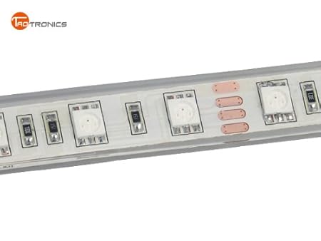

So when you cut the LED strip, will there be any loose wires to splice into on the next section? Maybe there will be, but I just cannot see them here:Originally posted by chpthril View PostThe strips are marked every 3 LEDs and can be cut to the length you need. The 300 LED strips are about 1.5" per section of 3 LEDs, so its easy to cut to near exact length when running a strip. With speaker and cup holder rings, its a little tougher.

WHen you buy a bulk roll, they typically come with leads only on one end. So each section you cut off, you have to either solder on your own leads or use the solderless connectors. In your pic, do you see the 5 gold ovals? thats where you would make your cut. There will be another spot to cut after the next 3 LEDs.Originally posted by talltigeguy View PostSo when you cut the LED strip, will there be any loose wires to splice into on the next section? Maybe there will be, but I just cannot see them here:

Originally posted by trudelle View PostTalltigeguy there should not be any wires from my understanding just solder points...they make connectors to use so that you do not have to solder.Thanks! I will look up some of those connectors.Originally posted by chpthril View PostWHen you buy a bulk roll, they typically come with leads only on one end. So each section you cut off, you have to either solder on your own leads or use the solderless connectors. In your pic, do you see the 5 gold ovals? thats where you would make your cut. There will be another spot to cut after the next 3 LEDs.Be excellent to one another.
